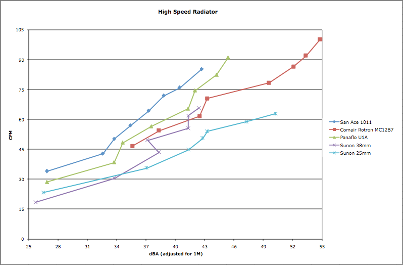

Here is a low speed fan review on radiators.
My personal choice:
For 25mm fans Yate Loons.
For 38mm fans Panaflo's or Deltas.
