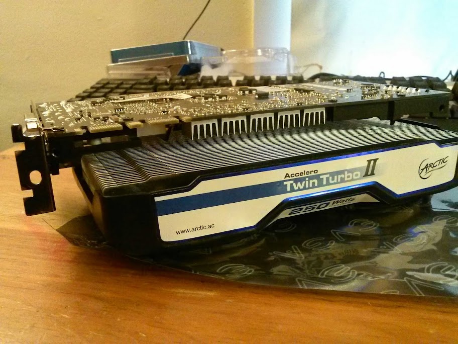

I finished my installation of the Accelero Twin Turbo II VGA Coolers.
Here are some pics:
After taking the cards apart and cleaning them, I installed the new heat sinks on the RAM. For the Voltage Regulators I modified the original heat sink.
I then attached the cooler to the GPU. You can't see it in the pics, but there are 5 copper heat pipes that go through the aluminum fins, with 2 92mm fans underneath.
First card installed.
There's very little clearance between the 2 cards, but luckily they fit. Each card takes up 3 PCI expansion slots. I also had to get a long flexible SLI bridge to wrap around the cooler.

Yes, it is quiet. I would say they're about equal to my noctua fans. The 2 biggest benefits from this conversion was better cooling and near silent fans. Ill report back with temperature differences. I still need to experiment with the side fan to see if it works better having it blow outside air directly onto the cards, or have it suck hot air out. My front fans are intakes, my top and rear fans are exhaust, so I have 2 intake, 2 exhaust, plus the side fan which could be either. When I had the original evga covers on, having the side fan was definitely better as an intake fan, but with these coolers I think having that be an exhaust fan might be more effective. Not sure yet.
