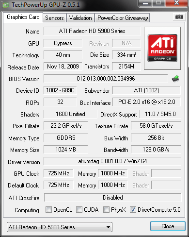

I've tried 11.3, 11.2 and the good last one i had on my rig before the upgrade and Crossfire does not enable on my 5970
before i had the i7 i ran Metro 2033 on DX11 very High with a Q6600 3.3Ghz / 4GB DDR3-1333 i got 30-50fps average now i go from 15 - 35 max... so i know crossfire is not enable and GPU-Z also see it not enabled
anybody have a clue ?

my Dual GPU 5970... it wont Crossfire like it used too on my Q6600 System

i might be mistaken, but i think hes talking about enabling internal crossfie between the two gpus on his 5970 pcb thingie.
its software for sure if it worked before.
when you go in the control panel what does it say?

i have no Crossfire enable option on CCC :(
yeah its internal Crossfire for my Dual GPU Radeon HD 5970
