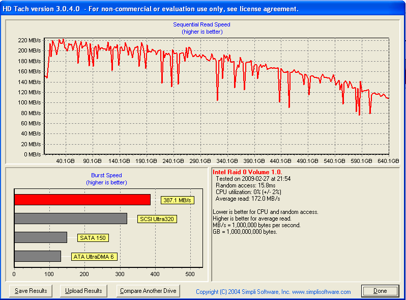

Well, here's what I've done...
I ran the three drives in RAID 0 by way of the 6 non RAID SATA ports on my mobo and used Intel's raid config. It was a complete breeze to setup!
This is the end result...
But why are those two partitions different colors? I know the large one at the end isn't allocated yet, but why the green
I'll do a couple of benchmarks in a bit and post them up...

Its just showing you that theres 831gbs of unused unpartitioned space on your drives, id just extend that misc files partition to take up the rest of it. I believe the way you have it set up means that 800gbs is inaccessible to windows to use as hard drive space, it needs to be partitioned for windows to be able to use it.
