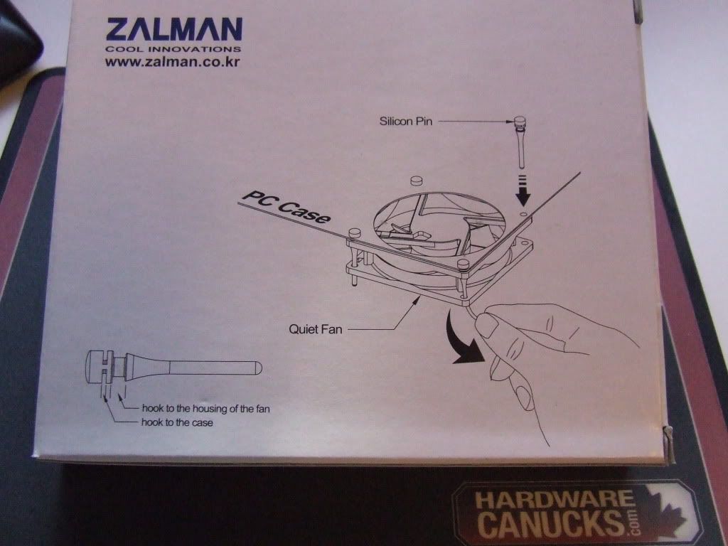

The box that contains the ZM-F3 is a fairly small and simple box. The front of the box contains the Zalman logo as well as a small illustration to help with installation.

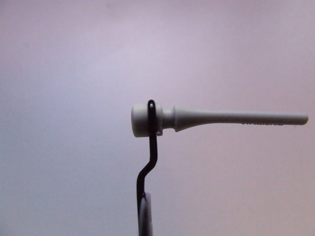

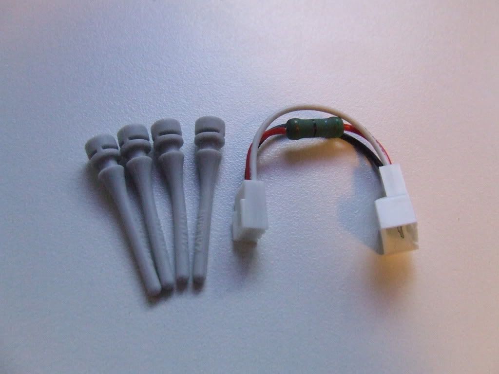

Inside the box we find a small plastic bag, as well as the fan itself. The small bag contains four rubber mounts, in place of standard screws. This is to help keep vibrations into the case down, thus reducing noise as well. There is also a 3 pin male to 3 pin female connector which has a resistor on the 12V cable, which reduces it to 7V. This is also an option to cut down on noise if silence is your goal.

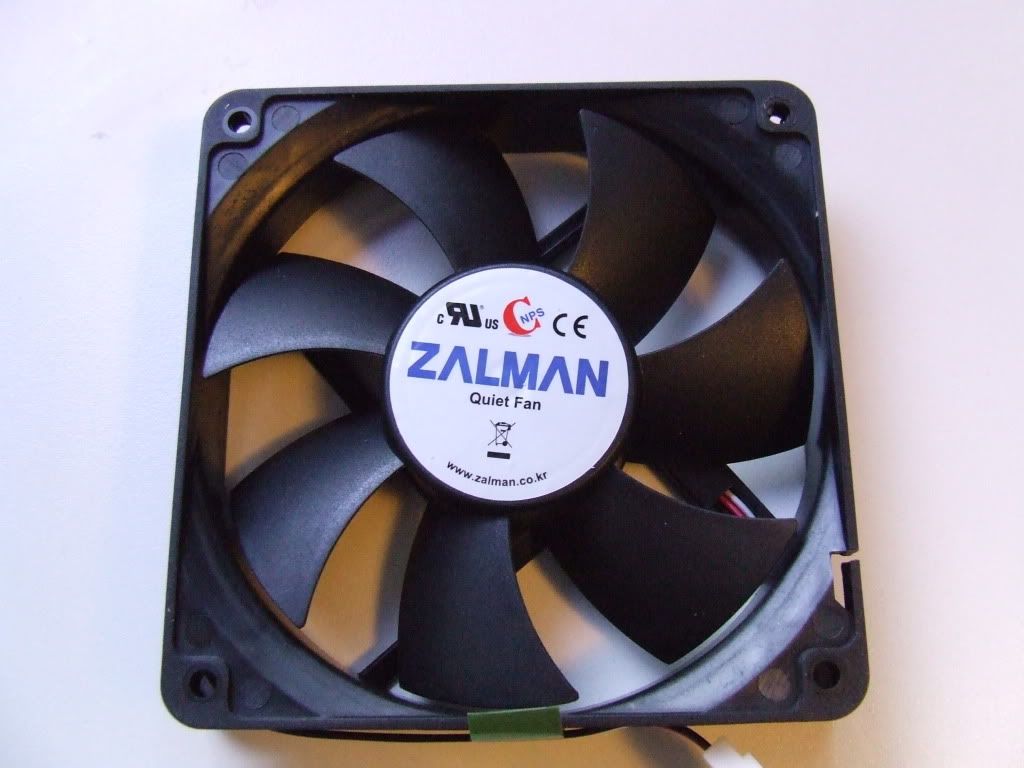

The fan features a black on black colour scheme and seven total fins. The front shows a Zalman logo, while the back has some technical information on it. Its' only connection for power is a 3 pin molex, which is something to take note of if you plan on purchasing many of them.

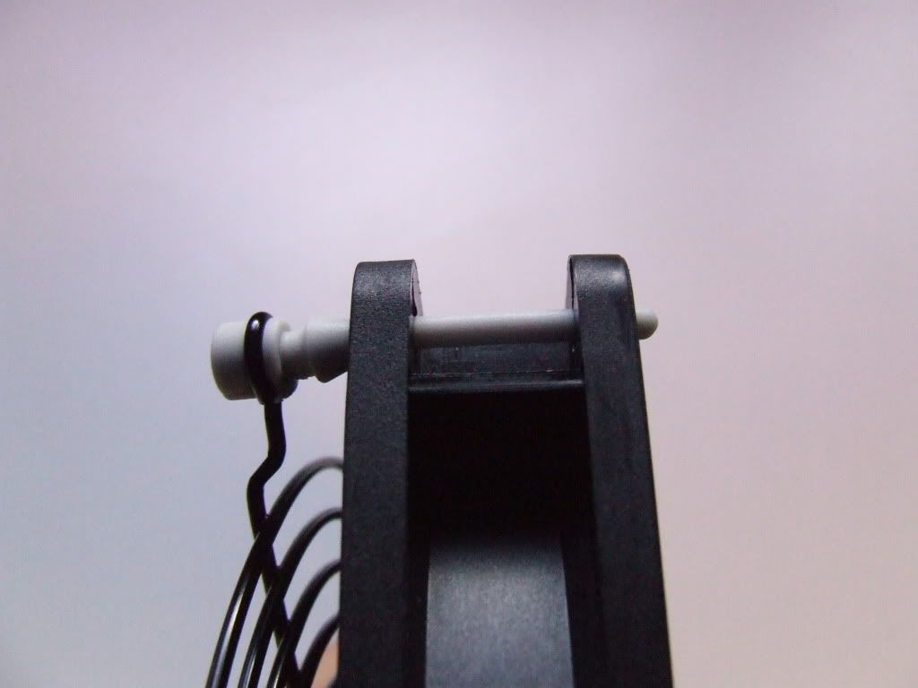

Installation is relatively easy, but the rubber mounts can be a bit tricky for those new to it. As seen on the front of the fan's box, the grommet is first attatched to the case (illustrated by a fan grill above) in the smallest gap on the grommet. After that, the grommet is then slid through both the front and back screw holes of the fan and is then pulled on until it snaps into place. The corner of the fan will occupy the large gap on the grommet. Repeat 3 more times and you have a solid mount to your case. If you are wondering, it is also possible to have a fan grill mounted with the rubber mount, you just have to make sure to stretch it enough so that the small gap for your case is filled by both the case and the fan grill.

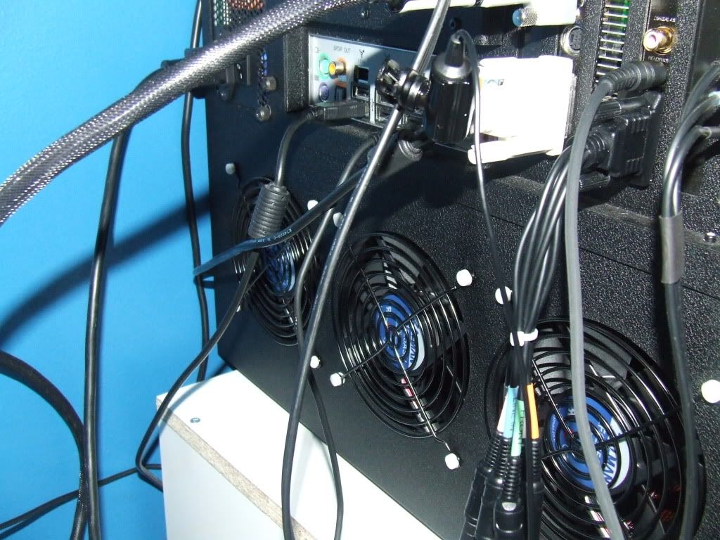

The reason I put barely is because I lack the skills and equipent to properly test the sound of this fan. With that said however, I have attempted to take a recording of the fan in action. Below is the extremely unprofessional setup. The only recording I took was of the fans at max speed.
The microphone used is the one included with the SteelSeries Siberia Fullsized headset, and connects through the 3.5mm jack on the breakout cables of my Auzentech Forte. Recording was done in "Audio Creation Mode" under the Auzentech sound control panel.
The link to the recording is below, and is approzimately 15 seconds long. Keep in mind, this is also an accumulation of four fans running relatively close to the microphone, as well as six more identical ones on the front of the case, just over 18 inches away.
zSHARE - fan recording.mp3
Overall, with ten fans running in harmony, it is pretty quiet. This isn't going to be running in your perfectly silent HTPC, but should be more than bearable for anyone not looking for ultimate silence.
I did not get a recording of the fans running at 7V as my microhone is not sensitive enough to pick up enough noise to make it worthwhile. At 7V, I believe this fan could even pass for a semi-silent build, and has zero problems starting up at that voltage (using a Sunbeam Rheobus).

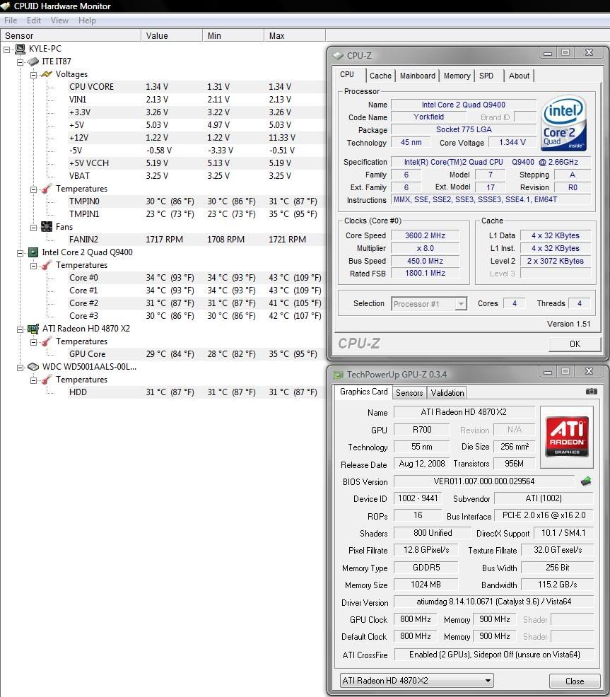

Load programs(15 minutes):
Four instances of Prime95, Large FFT
Furmark 1680x1050, Xtreme Burning Mode, MSAA 8x
Idle temperatures
Load temperatures
Discrepancies, Explanations and Overall Results
You will notice that my screenshots for idle/load only include one temperature for my video card. That temperature is of the hottest core (the other is usually 1 degree below).
You will also notice in the load screenshot that my current temperature is low as I exited out of everything before taking it. The max values are what my video card and CPU stayed at.
Overall, the results are a bit weird. In comparison, I used to run Antec Tricools in my computer. The CPU temperatures did not change at all, which I find odd as the CPU is right before the radiators. However, my GPU used to load at 39C, 4C hotter than now.
