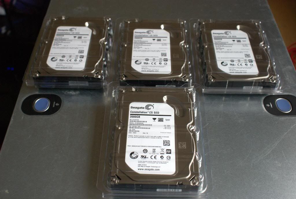

Also added 4 Constellation CS 2TB drives to the 4 Seagate drives. Eventually, these will be replaced by another set of Constellation drives.
