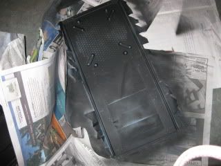

Part one: Paint job.
I guess i'll make a pretty detailed list of what to do, and wish that viewers hoping getting into the whole painting game can get some experience and knowledge from this. There are definitely a couple steps that are vital pre-paint as well as during the painting phase, though i did not wetsand in between coats which is a good idea for that 'perfect' finish.
Before the paint job, it's usually advised for you to derivet your case - the simple way (grab a 1/8th inch drill bit, throw it on the drill, and pop those rivets out!)
I derivited, and continued on to sand with 220 grit sandpaper.
It was a nice day out, so i decided to paint the same day.
The paint i used was: SEM brand self etching primer, 2 cans of Flat black tremclad paint, 2 cans of Wild Raspberry tremclad, as well as a can of satin clearcoat.
i drew a line inside my garage (less windy). make sure you're in a well ventilated area and are using a filtration mask prior to spraypainting.
and began priming!
the paint job before was rather rough, so i made sure to take extra care in the pre-priming steps. it is important to get a good surface to apply primer on, as well as making sure that it is clean.
a good idea is to wipe down with a non-lint cloth after sanding
after 3 coats of self-etch, (a can and a little bit) i let it cure for 2 hours.. off to the kitchen
back to the garage, and onto the base coat of paint!
a few more coats later...
more to come!
