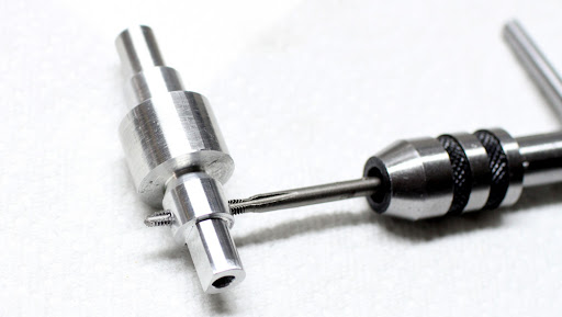

It's a typo, he means "tap". The fan mount threads on Swiftech rads are 6-32.

cut threads into material note just only go 1 thread past rad fan support or will punture rad
